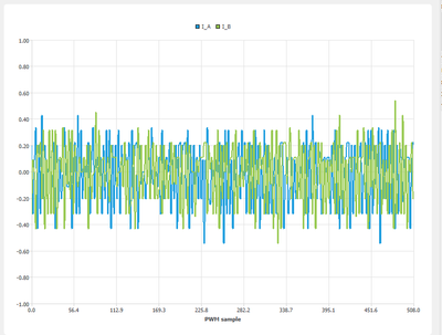

To do the bring up of a new board, the first step is to enable the open-loop support in the MCSDK, and then in the Motor Pilot you can select Open loop voltage, once the current shape is OK you can move to Open loop current. The open loop configuration is fully described in the User manual that you can find from teh MC Workbench: About->Documentation, it will open a new navigator window, and then it is in User Manual->Open loop Description and Usage.
Please, dump your current Ia, Ib in open loop voltage mode in your reply.

Thanks for the reply
This is the capture in Open loop voltage

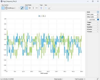

and this in open loop current
I forgot to mention that the shunt i am using is 1mOhm
STuser2
Senior III
i had difficulties controlling the motor at higher voltages when i used 1.1mOhm shunt resistor, then i moved to 2.2mOhm (i had two 2.2mOhm in parallel, i removed one) now i am able to control the motor better.
