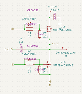

The schematic for the mosfet drivers is identical to the evspin32g4-dual:
33Ohm gate resistors and 1uF Boot Cap
I set the Boot charge time to 50ms and the Charging Duty cycle to 15%

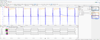

Below is a screenshot of the startup phase once the motor is running, orange: one phase, blue: voltage over shunt, the digital signals are the gates of all three phases. Why are the phases not shifted 120 degrees?

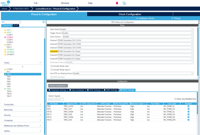

Are those errors in CubeMx (picture below) critical?

For error description and management, refer to the documentation available through Workbench tool > About > Documentations > Documentation > User manual tab, (FOC) firmware errors link.
Are you using the 6-step algorithm for expecting 120-degree phase shift? Refer to the User manual, Six-step firmware algorithm chapter.
STM32CubeMX warnings are not critical.
