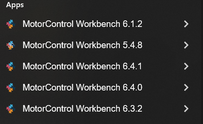

Project has been generated with MCSDK6.4.2, but on your ioc file "ExtraMW.MotorControl.Root=MCSDK_v5.4.8-Full/MotorControl" and in the project directory there is MCSDK_v5.4.8-Full.
Did you modify the wb2mx.properties file?
If you agree with the answer, please accept it by clicking on 'Accept as solution'.
Best regards.
GMA
Thank you for the reply, @GMA. I did not modify any project files; however, there are multiple versions installed on my computer (as listed in the attached image).
