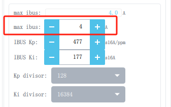

I added a custom REG in Motor Pilot and edited the MC_FOC_SDK.qml file, which allows usage, but I can only input integers, not floating-point data. Here is the configuration information.
RegListSTMV2.json
    "Id" : 162,
    "Name" : "OVER_BUS_CURRENT",
    "Description" : "max bus current",
    "Type" : "F32",
    "Unit" : "A",
    "Scope": "Motor",
    "Access" : "RW",
    "UpdateFrequency": "MediumFreq"
MC_FOC_SDK.qml
McRegGroupSpinBox {
    RegDesc {
            regName: "OVER_BUS_CURRENT"
            decimals:1
            label: "max ibus"
           from: 0
           to: 500
          stepSize: 1
         tooltip:"(0-500)"
LHOUE
Hello honkerz,
RegDesc is supporting integer only
You can use McRegSpinBoxFloat for float value
BRs
