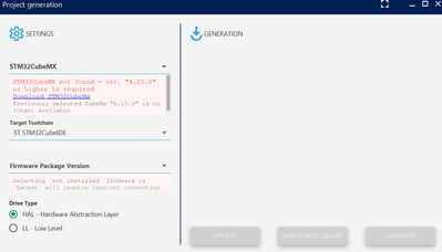

when i run my .stmcx file in stmcsdk 5.4.8v i am getting these type of errors ,how can resolve

Hello @dineshsharma2025,
Refer to MCSDK5.4.8 Release Note available through the Workbench tool > Documentation. The STM32Cube environment chapter provides the STM32CubeMX version and firmware package to install.
If you agree with the answer, please accept it by clicking on 'Accept as solution'.

THANKS @GMA  ,I WILL TRY FURTHER AND LET U KNOW
