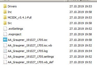

i want to use Nucleo F303RE & IHM08M1 together to drive a PMSM.
At first, I test the STM32CubeIDE with a led blink example, it works immediately.
Then I test my motor, in the Motor Profiler, it works too.

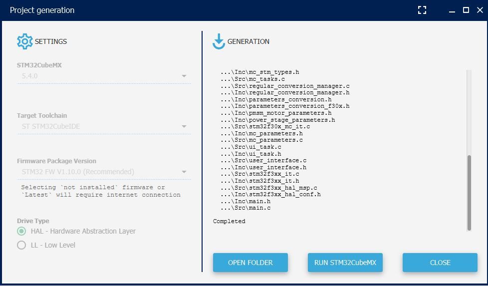

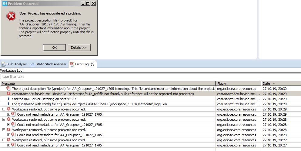

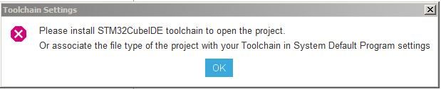

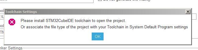

Now I want to use the MotorControl Workbench 5.4.1 FULL, to generate the source code for the STM32CubeIDE, but i get a toolchain error message. If I open the project in the IDE appears following error, in the approach are screenshots from my proceed.
I tried to use the codegeneration for True Studio in the STCubeIDE, without success.

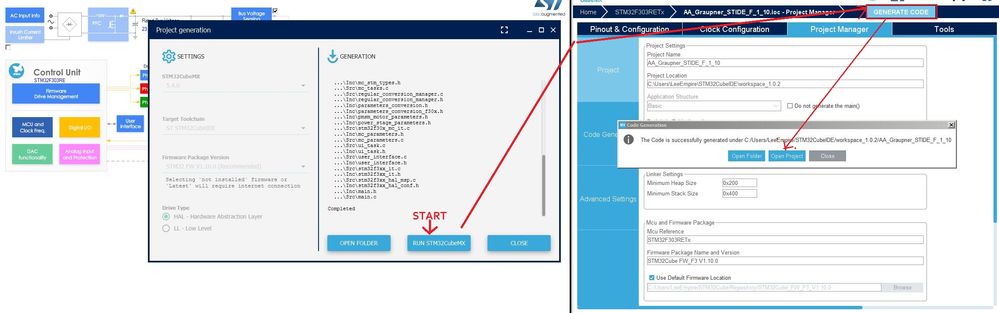

In Motor Control Workbench
[Run Cube MX]

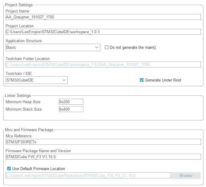

Options in Cube MX
 [Generate Code] -> [Open Project]
Open STMCubeIDE and the project.

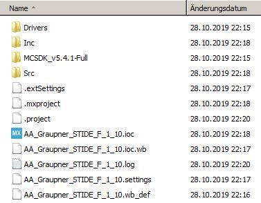

Please takes care to get complete STM32 tool suite up to date. Motor control flow is working fine on my side only if relying on latest STM32CubeMX (i.e. 5.4.0 release) and STM32CubeIDE (i.e. 1.1.0 release) releases.

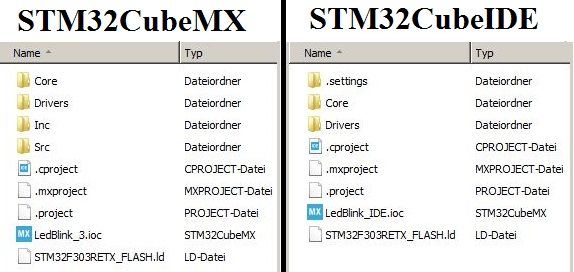

According your snapshots sounds obvious [Generate Code] -> [Open project] cannot work because lacking .project & .cproject files which are IDE (Eclipse in fact) prioprietary and mandatory ones. By the way still according your snapshots STM32CubeIDE repository doesn't exist at all …. ??
Your issue is why such files / directory are not generated ? … maybe tool suite install issue ...
What's sounds more weird is TrueStudio generation is not working …

The codegeneration works for TrueStudio on Motor Control Workbench, but why i should use TrueStudio, if i get build errors too ?
Today i installed System Workbench, i get only errors on tim.h ! It looks like constant parameters would be missing here. But this is a other topic.

 (edit) Definitely lies the problem on the Cube MX, I can only execute the LED blink example, if I create the project directly in the CubeIDE. When I open Cube MX and use code generate, it also comes the toolchain problem ...
