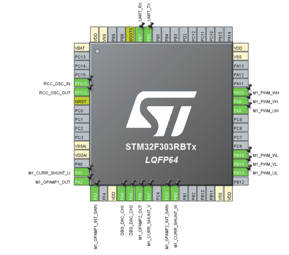

Dear Cedric,
Thanks for your answer.
Yes, I have already tested the cloning procedure, as suggested by you. I can achieve some results, like defining the timer/pins generating the PWM signals. I can obtain this result by working on the controller's configuration or redefining the connector's pin/port configuration.
I did not find a solution for controlling the microcontroller's analogue input for reading the phase currents and OVC protection.
I am working with a sensorless motor with three shunt resistors, and the base microcontroller's configuration definied using MCWB 5.Y.2 is shown in the attached image.
MCWB 5.Y.2 allows me to configure the microcontroller in this way:
internal gain of the opamp
external gain and bias offset of the RC circuit for reading the current level (I know how to calculate all the needed gains ad offset)
inverted pin of the internal OPAMP for adding an external capacitor for filtering purposes
threshold limit of OVC
I did not find a solution using MCWB 6.1.1 to configure the analog input section as described above.
Do you have any suggestions or documentation for reaching these results?

Hello Paolo,
Could you tell me from which boards did you start with 5.Y.2 and attach your IOC file to this thread?
I will try to come back with a suitable solution.

Hello @prigh.1​ ,
Here is the description file of your board, you can import it on the workBanch as "Inverter", then generate your project.
On the WorkBench, press "new project" then in "Select Motor Control Algorithm & Hardware" choose "Inverter.
click on the button in the upper right corner and add this file in the tool.
To activate the DAC Debug go to the Application Configuration tab of the WorkBench on the left.
Check that you have the right parameters, then generate your code.
After that, open the generated .Ioc file and set the 2 OPAMPs to "PGA Connected" mode.
Finally generate your code and try it.
can you give me a feedback to know if it works ?
Thank you
