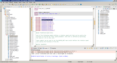

Im currently tring to program my nucleo-f103rb module. I have succesfully generated Motor control workbench project and CubeMx project. After code generation using cubemx , stm32cubeide1.8.0 opens the project code. Without changing anyting on the code , i pressed debug and 17 errors accured. I will share build console respons below.
Build console:

../MotorControl/mc_stm_types.h:30:12: fatal error: stm32f1xx_ll_rcc.h: No such file or directory
30 | #include "stm32f1xx_ll_rcc.h"
compilation terminated.
make: *** [MotorControl/subdir.mk:52: MotorControl/dac_rctimer_ui.o] Error 1

"make -j8 all" terminated with exit code 2. Build might be incomplete.
17:41:06 Build Failed. 17 errors, 0 warnings. (took 644ms)

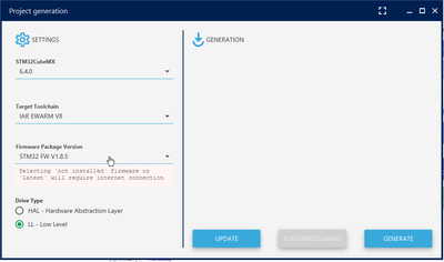

GMA
Could you please check that a Firmware Package Version is available when generating project:

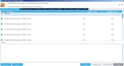

You can download it through CubeMx>Help>"Manage embedded software packages">STM32F1

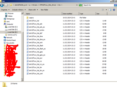

stm32f1xx_ll_rcc.h should be present in "Project\Drivers\STM32F1xx_HAL_Driver\Inc" directory.

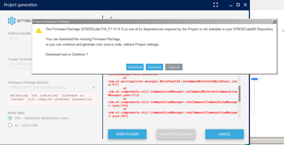

Hi.
I just check it and there are some other problems about generating and debuggin.

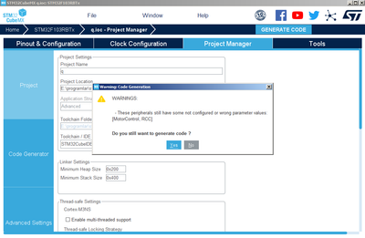

Firstly when generation project using motor control workbench 5.4.8 software gives some error about java . I will share here screenshot and complete error code.

Those are only error outputs from project generation screen of mcsdk. It completes with error. Anyway when i with Run CubeMX , its opening and all pins are correct.
Without changing anything on the CubeMX and after type name of project and select output for STM32CubeIDE , i click to generate button. After that event , an error massage pops up and says;
 After your succestion i have check the firmwares on the cubemx and 1.8.5 and 1.8.4 was already installed. For tring to find solution i also installed other firmware down to version 1.8.0. When i select to install version 1.8.0 , it tried to download and install but it gave and error message which it says, this version is already installed. you can see installed firmwares below;

My cubeIDE is 1.8.0 version. Without changing anything on the code , i pressed the Debug button and 17 errors dissaperad. You can see below;
 It seems when generating files , some files are missing or something. Also you can see the file that you have mentioned your last post below ;

On my side, using WorkBench5.4.8, CubeMx6.4, F1 FW package1.8.4 and your test1.stmcx, project generation works.
Sound strange that a FW package1.8.5 message appears when 1.8.4 is the recommended one....
Then, could you please, un-install FW package STM32F1 1.8.5 using CubeMx interface Help>"Manage embedded firmware packages" clicking on 1.8.5 line, Select Remove.
Un-install CubeMx6.4 using windows "settings>Apps & features" tool.
Install CubeMx6.4, and generate a new project from a new directory.
