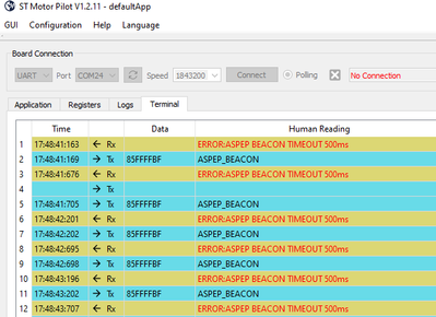

Hello everyone,
I have a motor control project that I'm testing out using Motor Pilot. If I generate it with FreeRTOS support, Motor Pilot can't connect to the board (the board sends a probably malformed ASPEP_RESP and then it's always a timeout).
I have verified that motor control code is working correctly with test code (the motor spins as expected):
void test_task(const void *arg)
vTaskDelay(5000);
(void)arg;
MC_AcknowledgeFaultMotor1();
MC_ProgramSpeedRampMotor1_F(250, 1000);
MC_StartMotor1();
vTaskSuspend(NULL);
Noticed that void ASPEP_HWReset(ASPEP_Handle_t *pHandle) from aspep.c is always getting called.
If I untick the FreeRTOS button in the workbench and regenerate the code (keeping all other settings), then MCP works as expected.
General params:
  • MCSDK 6.3.0
  • FOC
  • EVSPIN32G4
Maybe this is known issue and there's a fix/workaround?

Hello @grisharevzin ,
Could you try with the latest version of MCSDK (6.3.1) which has been released?
It should fix your issue.
BRs
If you agree with my answer, please accept it by clicking on 'Accept as solution'.
September 25, 2024
Hi @LHOUE,
I've regenerated and recompiled everything with 6.3.1, same issue (void ASPEP_HWReset(ASPEP_Handle_t *pHandle) is always getting called if I'm trying to connect with Motor Pilot).
November 14, 2024
Did you find a resolution to this issue? I am having the same problem
November 14, 2024
Nope, sorry. It's either FreeRTOS or MCP. My intuition tells me it should be easy enough to debug but I didn't go this way.
