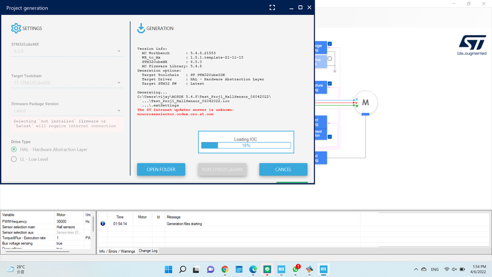

I am also facing the same issue. However, in my case:
Motor COntrol Workbench: 5.4.8
ST CubeMX: 6.5.0
CubeIDE: 1.9.0
When Click on generate new Project, it generates the source file with many errors.

Vijay Ganisetti
April 6, 2022
Helli @cedric H​ ,
When click on generate, and after all the source files generated. Click on close an error occurs "Generation failed".

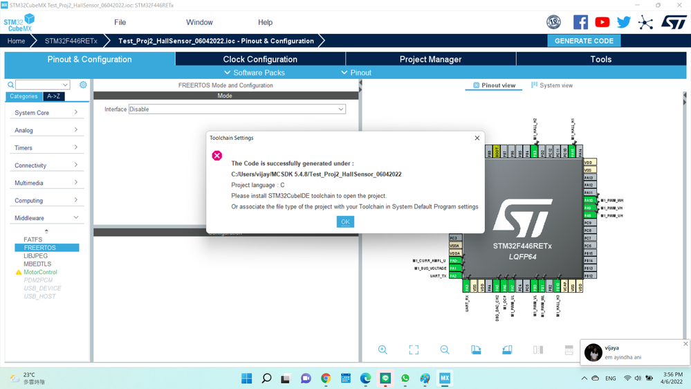

Hi @cedric H​ ,
Opened CubeMX and generated Code, but an error exists. Previously, in older versions, this error doesn't exist.
Help me to solve this issue.
cedric H
April 6, 2022
@Community member​,
I do not see any error in your attached screenshot, the pop-up window states that your code is successfully generated.
You selected the STM32CubeIDE toolchain, and it seems that this toolchain is not installed.
If you want to generate a project for another compiler, you can configure it in "Project Manager" tab.
Or you can download stm32CubeIDE for free here.
Cedric

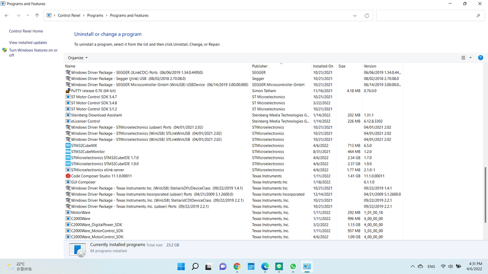

Vijay Ganisetti
April 6, 2022
Hi @cedric H​ ,
I already installed latest version, cubeiDE 1.9.0
cedric H
April 6, 2022
Ok, then you should be able to open your generated project by double clicking on your .cproject file located here :  C:\Users\vijay\MCSDK 5.4.8\TestProj1_HallSensor_06042022\STM32CubeIDE
It is weird that cubeMX did not find your cubeIDE installation.
Cedric
