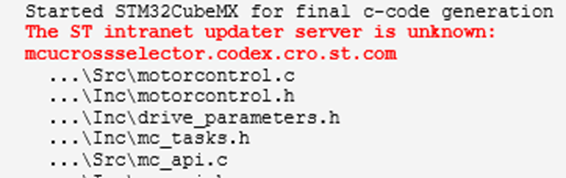

I designed a custom inverter using an STSPIN32G4, with the same topology of EVSPIN32G4, and so that is how I initiate the project in Motor Control Workbench.
I set it up for speed control and hall effect sensors feedback as the primary and only speed sensor. I have used this setup many times before in earlier versions with no issues.

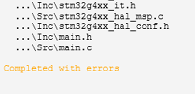

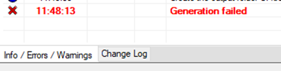

During code generation, I get the following error:
“The ST intranet updater server is unknown: mcucrosselector.codex.cro.st.com�?
and also,
“Completed with errors�?
0693W00000JO2ewQAD.pngIn the main log, I get:
“Generation failed�?
The code seems to compile fine in CubeIDE 1.8.0 with no errors.

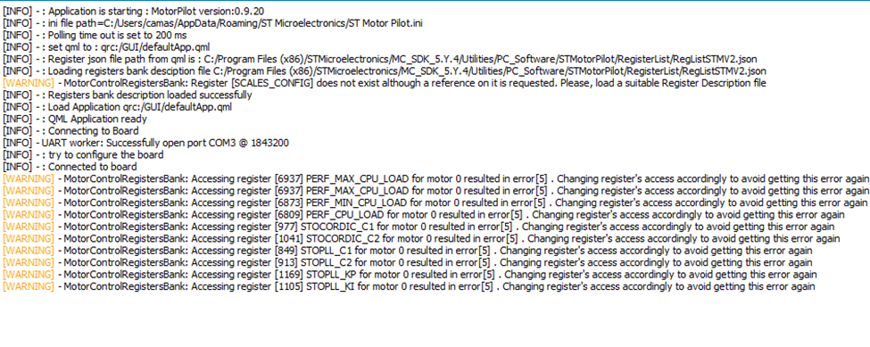

The board does connect with Motor Pilot about 50% of the times I try, but immediately I get the following errors.
0693W00000JO2h1QAD.pngFinally, from the main dashboard I get an over current fault, but if I click on Acknowledge Fault, nothing happens.

Hi SE D.1
If you are getting the same "Generation Failed" error when generating the code, that I refer to in my original post, what Cedric said is that that error could be disregarded, at least in my case given the screenshot I provided. I recommend you reading again his answer to my post.
He also mentioned that ST will probably fix it, but the code generated should work just fine. Once I realized that I could just ignore this error, I ran it and it worked for me.
Assuming that is the error you are referring to, try to run the generated code in CubeIDE and it should work for you too.
