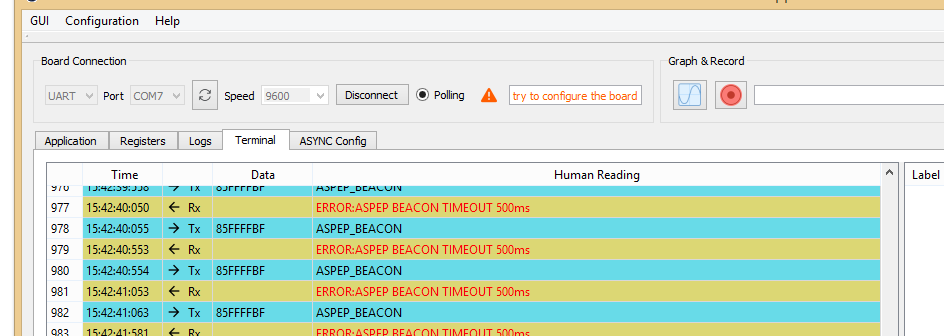

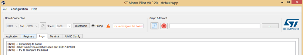

Anyway... I compile the project in STM32cudeIDE and I click on "run" to program the microcontroler on the board (SPIN3204)
I return to ST MC workench (ver 5.Y.4), and I click on "motor Pilot"
When I click on "connect" I obtain this answer:
0693W00000UFXFYQA5.pngIt is written "try to configure the board", and in the application, all is grey, I can't use it.
In the terminal windows, I have this:
0693W00000UFXK4QAP.pngWhat must I do??
Can you help me please?
