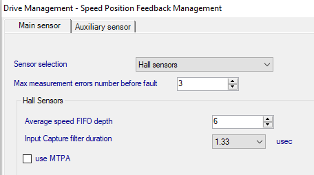

I currently done the code for bldc motor working in stm32 cube ide .I am using STM32F103C8T6. What I need to change in my code to control my motor using HAL sensors?

Hello CS S.1,
First we would like to apologize for the delay in replying to your post.
If your point is still relevant : Hall Sensors speed sensing can be enabled via Workbench by clicking on Drive Managements, and selecting Hall Sensors in the scrolling menu, as shown in the picture :
