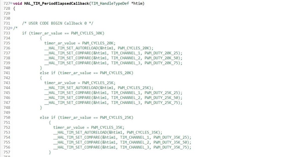

Yes, it is brushed DC motor. According to the motor parameters, motor control workbench suggests best operating conditions at 30kHz. i want to use random PWM rather than fixed PWM frequency in order to spread the frequency spectrum of the generated PWM.
Yeah i tried to update ARR of the timer using a function but its not working. Can you suggest any idea to update ARR in runtime?

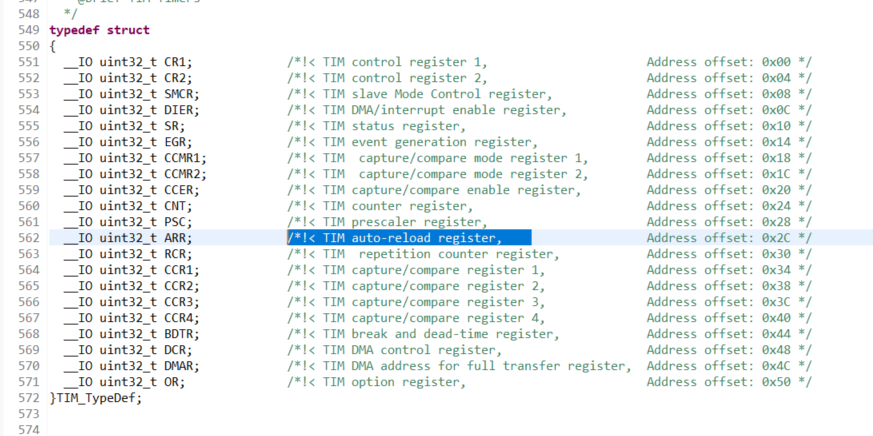

TIM1->ARR=89;
Maybe have some DMA loading the TIM ARR register constantly? from a lookuptable of values.
