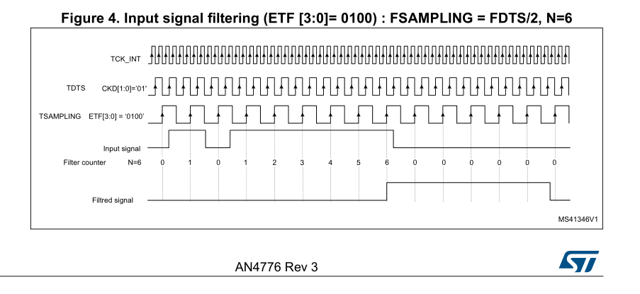

I fail to see how this works as a filter.
The following figure from AN4776 illustrates how the input capture filter rejects short pulses (i.e. noise):
0693W00000Kb3BaQAJ.pngIt's not a perfect solution, of course. It introduces delay, and it's aimed at removing random switching noise not periodic interference (in which case it may produce confusing results).

You are not specifying the chip, so I took G4 series as an example. Ref. manual RM0440 Rev 6 says in 28.3.9 Input capture mode "Let’s imagine that, when toggling, the input signal is not stable during at must 5 internal clock cycles. We must program a filter duration longer than these 5 clock cycles.". So the filter is just debouncing transient transitions. It is named "Filter downcounter" in the figures.
ICPS is a prescaler. No idea what it is used for except for extending the counter range.

> What kind of filter is this?
It's very simple: if input level changes, output changes only after filter samples the same level for the prescribed number (N) of samples. You can select several levels of N and several prescalers for the sampling frequency.
Wouldn't the prescalers divide the input pulses, so you'd need 4 or 8, or whatever, to get a single count?
The clock divider of the filter drops the sampling frequency, ie clocking of the synchronizer circuit
Sorry for the confusion with the many prescalers:
  • there is a common prescaler for filters in all 4 channels (and for dead-time detection where applicable), set in TIMx_CR1.CKD (resulting in fDTS)
  • individual settings of TIMx_CCMRx.ICxF use a further subdivision of either directly the timer's internal clock (***_INT) or its prescaled version (fDTS)
  • as Clive said above, IC1PSC determines, after how many filtered edges will an actual capture occur.

> What you're describing seems like a counter.
You can look at it as a counter. This is exactly how debouncing algorithms work in software, too.
> If it's the case, how is the hysteresis working?
What hysteresis are you referring to?
>  From my observation, I don't think it's the case.
> The filter seems to behave like a low pass filter: filtering out rapid variations, regardless of the number of edges.
ICxPSC does not control the filter itself.

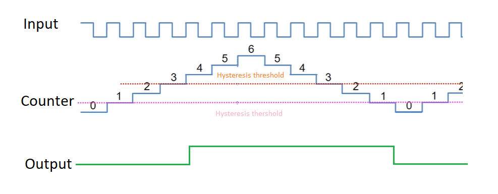

Hi everybody,
I think I don't understand what you're saying.
When I implement a low pass filter with a counter, I put two hysteresis thresholds.
Here's a rapid drawing about the relationship between the input, the counter and the output.

The AN4776 had the details needed.
