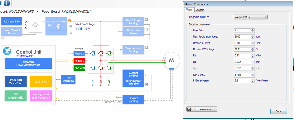

Raül G
I found where I can introduce the motor parameters in the ST Motor Control Workbench.
After introduce the "correct values" of the motor, the motor dont move.
0693W00000HqPQQQA3.pngI tryied to configure the hall sensors to be used as a main sensor, but the problem remains. Also I placed the Jumper JP3 in the IHM07M1 board.
Any idea?
By the way...If I don't want to use the Hall sensors, what's the most apropiated sensor-less? Oserver+PLL? Observer + Cordic? HFI+Observer?
Thanks for your support!
Raül.
cedric H
JP3 can be always closed. It does not hurt if you run in sensor-less mode.
HFI is not supported anymore. As a first try, I would advise you to start with Observer+PLL.
Hall sensors configuration requires some tuning. Hall sensors topology and Electrical delta angle must be known and filled in the Sensors tab of the motor parameters. Be aware that with Hall sensors, the order of the phases does matter. (which is not the case in sensor-less)
Last point, the nominal current value in the WB represents the max current the motor can sustain without damage, the value you enter is the typical current without any load. I suggest you to increase this value.
Regards
Cedric

Raül G
Hello @Laurent Ca...​ and @cedric H​ ,
thanks for your support, but unfortunatelly the motor don't works.
Of course I replaced the nominal current and also I tested all wiring motor configurations to try to match each motor winding with the Hall sensor, but the problem remains.
I tryied to move the motor with a low cost ESC made for radio controller and it works, but as expected it have problems at low speed.
I'm thinking to buy the STEVAL-ESC001V1 evaluation board, do you think I will have the same problemas as the X-NUCLEO-IHM07M1?
Any idea? Anybody can suggest me a hardware modification to increase the current detection? I have an oscilloscope if it is necessary to check at any point...
BR,
Raul
