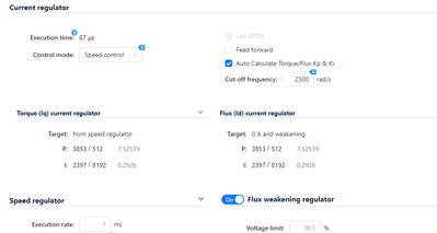

I want to use the flux weakening in my project using Workbench 6.2 i generated the code using the below setting
when i select the speed control mode i can see the tab to select the Flux Weakening regulator.

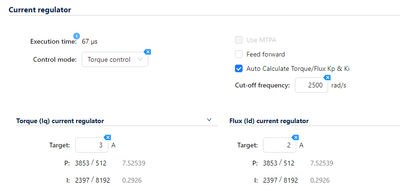

But when i select the torque control mode
The tab for the flux weakening regulator does not appear. I know the flux weakening regulator is used to increase speed. The code for flux weakening does not generate in Torque control mode. So can i use the flux weakening code in torque control mode or not? Can i use the negative Id to increase the speed limit.

Hello SRedd.5,
Using Flux Weakening in Torque Mode can be counterproductive. In fact, when reaching the speed limit for which the Flux Weakening is enabled, the algorithm will set a negative Id value, thus speeding up your motor. However, this can lead to a decreasing of your Iq value, which will overwrite your current reference. In that case, you end up with a Torque Control Mode without any idea of your torque value.
Moreover, in Speed Mode Flux Weakening, there is a point where your PID Speed is regulated thanks to PID_SetLowerIntegralTermLimit. This is rendered useless in Torque Mode, so the Flux Weakening may be able to increase your Id value to the point of motor demagnetization.
