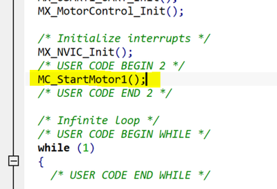

I just started to use EVLDRIVE101-HPD for a 36V 50W hallsensor PMSM motor. The SW creation process (MotorControllerWorkBench -> STMCubeMx -> STMCubeIDE -> Build Project) works fine and I can build and debug the code. However, your whitepaper "um3257-getting-started-with-the-evldrive101hpd-compact-circular-reference-design-based-on-stdrive101-for-highcurrent-brushless-motors-stmicroelectronics" indicates that this motor control EVK shall include means (HW+SW) for easy start/stop via J8-5 and speed control via a potentiometer connected to J8-7. Something the content of your JSON file confirms. But the code generated does not contain this function and CubeMX do not assign the pins.
Can you please say where to find (or send me) example code to get this operational, e.g a code that starts/stops via J8-5 and regulate speed via J8-7?

Hi @Mohrlund ,
to regulate the speed via J8-7 you need to connect an external potentiometer to that pin as explained in the json file. The generation of the code is activated enabling the flag "Potentiometer" in the section "Stage configuration" of the workbench.
As far as the start/stop via J8-5 is concerned, this pin is meant to be used with an external hardware trigger switch. When J8-5 is not grounded the power supply is disconnected from the MCU and no communication is then possible with the board (please refer to schematics). So, there's no code to handle it. On the other hand, if you want the motor to spin as soon as you press the trigger switch, you only need to add the API function call   MC_StartMotor1() in main.c, in the position indicated by the attached picture.

Thanks for a very swift and accurate reply Alessio!
Activating the "POTENTIOMETER" flag made CubeMX add that pin, but nothing shows up in the code as far as I can see. What is the intended function of this flag in the code (and behavour when running the motor?)
Adding MC_StartMotor1() to main.c made indeed the motor to start spin, but only for 1-2 seconds. Then it stops without any information. Do you know why?
Can you please also tell how to use the UART interface to monitor the motor?
Thanks!
