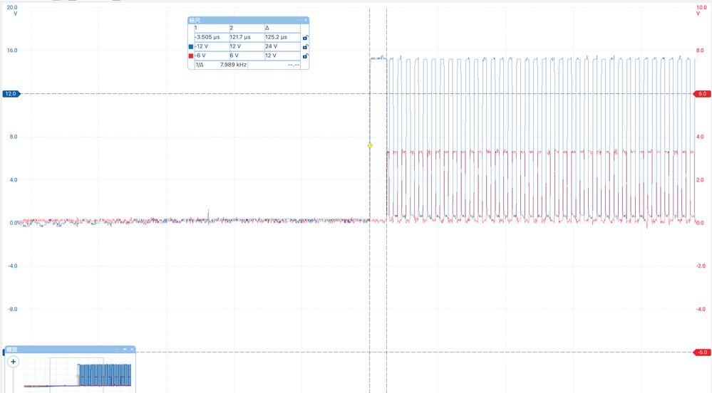

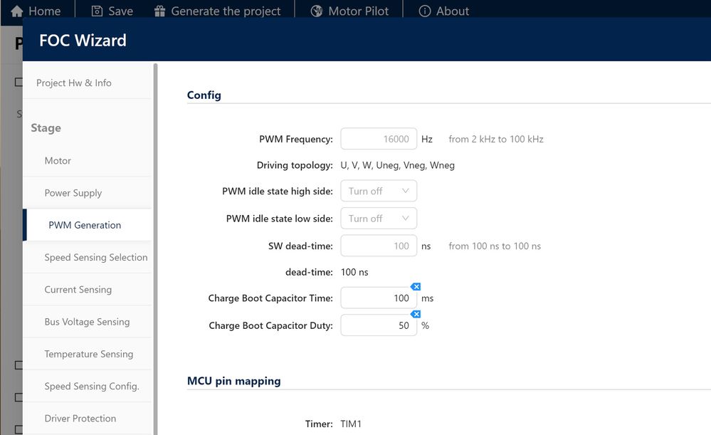

hi,
    I set the charge boot capacitor time with 100ms and the duty with 50%.
the picture is below,
and I captured the waveform by the scope. low side (green,16V from drive circuit),high side (red, 3.3V from MCU). the low side boot time is 125us. why is not 100ms?

    Hello @tonyqian926,
    Please, have a look the following application note.
    These Charge Boot Capacitor settings concern the phase on which only Low Side Switches are driven for capacitor charging before going to START phase.
    If you agree with the answer, please accept it by clicking on 'Best answer'.Best regards.GMA
