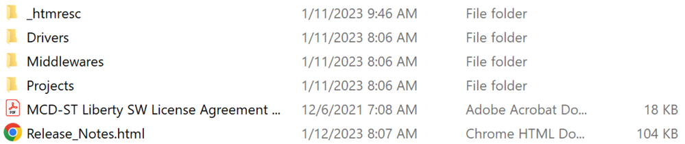

2. Porting
Let us understand what the process of using the package in a custom application looks like. First, let us understand the directory structure of the EEPROM emulation middleware in the directory Middlewares\ST\EEPROM_Emul:
The Core folder contains the hardware agnostic section of the middleware. This code is needed for any STM32 running the EEPROM emulation.
The porting folder contains subdirectories that contain the files necessary for working with a specific family of MCU:
Each one of these MCU specific folders contains two files, flash_interface.c/.h
This defines how the package interacts with the internal flash memory, and thus is different different for each MCU family, unlike the source code found in the Core folder.
To port the middleware into your project, you firstly need to copy all files from the Core folder into your project that is.
  • Copy eeprom_emul.h, eeprom_emul_conf_template.h, and eeprom_emul_types.h into an include directory in your project.
  • Rename eeprom_emul_conf_template.h to eeprom_emul_conf.h
  • Copy eeprom_emul.c into a source code folder of your project and be sure it is included in the build.
Now, navigate to the relevant folder in the porting folder, depending on which MCU family you intend to use:
  • Copy flash_interface.h into your projects include directory
  • Copy flash_interface.c into your projects source folder and ensure it is included in the build.

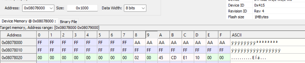

Hi @Laurids_PETERSEN maybe you can help me.
I successfully ported the emulator to my custom STM32L4 machine. I updated my parameters to the following
#define START_PAGE_ADDRESS 0x08078000
#define CYCLES_NUMBER 1U
#define GUARD_PAGES_NUMBER 2U
#define NB_OF_VARIABLES 10U
I can successfully initialize my flash and write data (and read data) if it's all within the same boot cycle. I double checked with ST-Link Utility.
ee_write_flash_16bit((uint16_t)4321, (uint16_t)0x0002);
But if I power cycle and attempt to write or read to flash again, I get error code 0x03 EE_ERROR_NOACTIVE_PAGE.

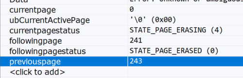

I stepped through the code my current page had the state STATE_PAGE_ERASING instead of STATE_PAGE_ACTIVE.
Any clue what I'm missing here? My current workflow is
1. Init flash with FORCED_ERASE once.
2. Write to flash.
3. Hard reset.
4. Write or read from flash <-- this is where I get the error.
Thanks in advance

Feb 26, 2026 8:38 PM UTC
Just commenting to add what fixed my issue. My CRC configuration was being changed by my AES Encryption calls. So the CRC value I read from flash did not match what was initially written. I solved this by saving my CRC configuration after EE_Init, and restoring the saved configuration before every write and every read.
Working great now!
