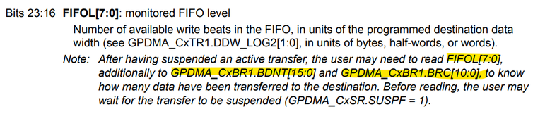

Thank you. The DMA channels have FIFO buffers (8 bytes in my case). And and the GPDMA_CxSR.FIFOL[7:0] bits contain the remaining write beats of the FIFO.

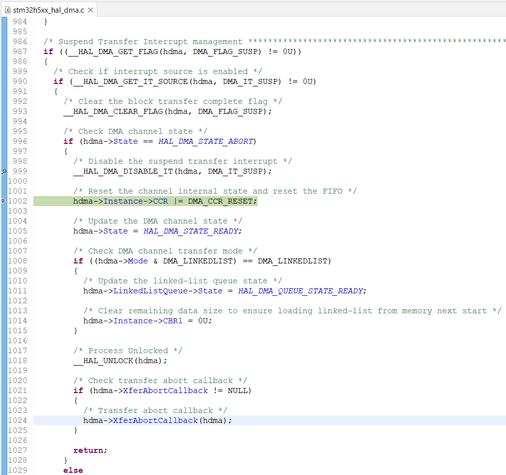

The problem I have now is that the HAL lib resets the fifo before calling the abort callback ...
I will try moving the call of the callback up to line 1000.

__HAL_DMA_GET_COUNTER will return the value of the NDTR register.
The NDTR register starts out at the length you're sending and it ends at 0 when the transfer is complete. So if you send 10 bytes, and it's 7 in the error callback after a NACK, the NACK happened after 3 bytes were sent. Might be off by 1 if it preloads but I don't believe it does.

You may want to read the explanation to GPDMA_CxSR.FIFOL in the GPDMA chapter of RM0481.
