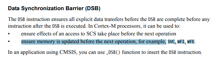

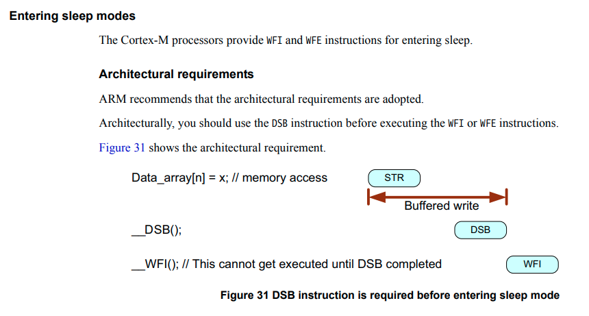

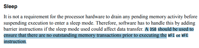

Why isn't the DSB (Data Synchronization Barrier) instruction used instead? This seems like a better fit for flushing pending instructions. From the ARM docs:
0693W000008zZ2nQAE.png0693W000008zZ8nQAE.png0693W000008zZ9HQAU.pngSo it seems to me that NOP could be "good enough" in many cases, but in case there is a long-running memory operation queued up before, say, WFI, then DSB would be a "safer" choice. Is that true and would there be any drawbacks? Why did ST choose to use NOP only?
