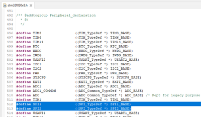

You haven't explained yet what you mean by, "compiler may not recognize the own register-level code, such as 'SPI1->DR = (uint16_t)(tx_data << 8);'"
Is it giving you an error, or what?
     "You haven't explained yet what you mean by, "compiler may not recognize the own register-level code, such as 'SPI1->DR = (uint16_t)(tx_data << 8);'"
    If I add "SPI1->DR = (uint16_t)(tx_data << 8);"  which I copied from some register based STM32 SPI project C file , to my CubeMX project C file. Do you think CubeMx IDE compiler will compile it with no error on "SPI1->", ?
    "SPI1"  is not defined anywhere in my CubeMX project C/,h file; it was copied from some register based STM32 SPI project C file. Please advise.
    Thanks,
Rong
Of course it's defined - the LL and HAL code use it!
It'll be in the stmxxxxxxx.h file for the chip you're using; eg, for stm32F030x8:
Why don't you just try it?
