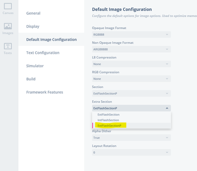

This is something very easy that I am missing or impossible. I am using a nucleo-l476 to drive an RA8875 with a flash memory attached. This is using touch gfx to drive the RA8875 LCD. I am switching in/out of memory mapped mode to rewrite part of the flash memory so I can load different images into the flash memory and touch gfx will load the new images from the nor flash (This all works beautifully).
what I am trying to do is have touch gfx load an image to a different part of the nor flash using partitioning.  see linker below.

Yes quite easy (but hidden feature). Open your touchgfx file with a text editor and add your new ExtFlashSectionP  section like such:
   "AvailableSections": [
      "ExtFlashSection",
      "IntFlashSection",
	  "ExtFlashSectionP"
After that, you should be able to select it from the drop down list in your images settings for instance:
Your linker looks good to me. So with only the changes i mentioned above, it should be working.

Thank you very much Osman, Will try this and let you know.

That was very easy. Thanks again Osman SOYKURT for your help.
Brief edit and update.
System is working well with Touch GFX  loading the replaceable image to the new flash partition (so as to not effect the rest of the images stored) and  loading new images from SD-Card to the flash partition. With this method I could add more partitions and load other images to separate sections.
