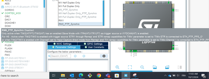

I had some issues configuring H573 with CubeMX.
When I configure TIM2 or TIM3 according to the instructions of RMII_PTP_Synchro in CubeMX I cannot enable the RMII PTP functionality.
And when looking at RM0481 it seems that the description of the relationship between these two timers and ETH MAC is a bit vague.
What configuration is required to enable RMII_PTP_Synchro on H573?

There are two ways to activate RMII_PTP_Synchro for the H5: First, by enabling TIM2 and TIM3 with the trigger source set to 'ETH1 through Remap' and configuring the ETR remap capabilities for TIM2 to "TIM2 ETR is connected to ETH_PTP_PPS_O" and for TIM3 to "TIM3 ETR is connected to ETH_PTP_PPS_O".
Alternatively, you can enable TIM2 and TIM3 with Channel 1 set to 'Input Capture Direct Mode from Remap' and set the TI1 remap capabilities for TIM2 to "TIM2 Channel 1 is connected to ETH_PTP_PPS_O" and for TIM3 to "TIM3 Channel 1 is connected to ETH_PTP_PPS_O".

I enabled Trustzone when I created the project and followed the recommended configuration in the software, but RMII_PTP_Synchro is still not selectable.
am I missing something or is the feature not optional when Trustzone is enabled?

I'm still having this issue with STM32H563RGT6.
In CubeMX, I've enabled TIM2 as slave (External Clock Mode 1), Trigger Source as "ETR1 through Remap", Channel 1 as "Input Capture Direct mode from Remap".
ETR remap capabilities for TIM2 = "TIM2 ETR is connected to ETH_PPS".
Input Capture channel 1 => TI1 remap capabilities for TIM2 = "TIM 2 Channel 1 is connected to ETH_PPS".
(See attached screenshots for details)
However, RMII_PTP_Synchro is still greyed out.
I've tried with and without Trustzone, but still have the same problem.
Is there anything that I'm doing wrong ? Do you have any update on this ?
