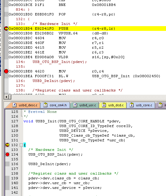

Hi all,

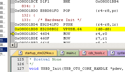

With Keil MDK-ARM I had a random hard fault when I change the optimization level of the compiler.
The reason is a VPUSH.64 assembler instruction that tries to use the FPU. This instruction is added by the compiler before entering the main() function, so, at this point, the PFU is not enable.
I found a solution at http://e2e.ti.com/support/microcontrollers/stellaris_arm_cortex-m3_microcontroller/f/471/t/155025.aspx?PageIndex=2
Edit startup_stm32f4xx.s file and add the following code in the Reset_handler
                ; CPACR is located at address 0xE000ED88
                LDR.W   R0, =0xE000ED88
                ; Read CPACR
                LDR     R1, [R0]
                ; Set bits 20-23 to enable CP10 and CP11 coprocessors
                ORR     R1, R1, ♯(0xF << 20)
                ; Write back the modified value to the CPACR
                STR     R1, [R0]; wait for store to complete
                DSB
                ;reset pipeline now the FPU is enabled
                ISB

Posted on April 12, 2012 at 00:23 Thanks for the information, it is very interesting. Now I can complete the information. I agree that the “random�? word in the title is not appropriated. I am using the latest version of
http://www.st.com/internet/com/SOFTWARE_RESOURCES/SW_COMPONENT/FIRMWARE/stm32f4discovery_fw.zip
and Keil MDK-ARM 4.50 (I tried to upgraded it from 4.23 in order to solve this issue, but no luck). The projects in the firmware package utilize the startup_stm32f4xx.s in this path: STM32F4-Discovery_FW_V1.1.0/Libraries/CMSIS/ST/STM32F4xx/Source/Templates/arm/starttup_stm32f4xx.s Head of the file and reset handler are showed bellow. The FPU IS NOT ENABLED HERE.

So the problem is with the starttup_stm32f4xx.s file distributed with the discovery. Well, now about the term “random�?. When I put the compiler at optimizing level -O3, all worked well. But I prefer to disable optimization when I debug. In this case, the compiler generates FPU instructions before I have the opportunity for enabling the FPU from C code. See image bellow. 0690X00000605TvQAI.png I don't know the reason for that. But it seems highly dependent on the code of the project. You change some parts of the code, and these offending instructions disappear. Regards, Àngel

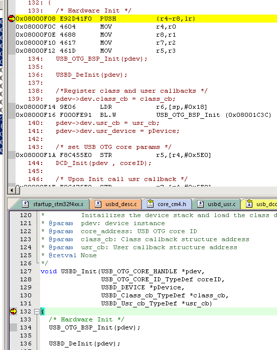

I tried to find the reason for the generation of V* instruction, but without fortune.
I removed all my modules that use floating point and played with optimisations.
Bellow is an image of C optimization level -O0 generating V* instructions (bellow the PUSH instruction). This happened in a call to a USB initialisation:
If I increase the optimization level (-O3). The V* instructions disappear. So no hard faults.
It seems that it happen in calls to complex functions with lots of parameters.
In any case, enabling the FPU its the workaround for me.
Regards,
Àngel

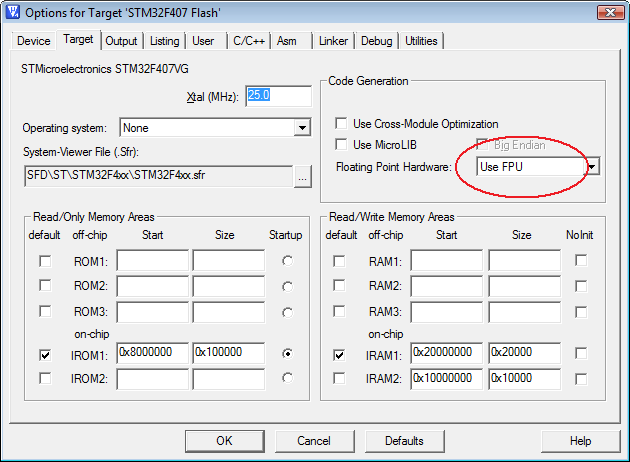

Don't want it generating FPU instructions, and/or don't want to enable the FPU, make sure the project sets the ''Floating Point Hardware'' option to ''Not Used'' instead of ''Use FPU''.
If you think there is a compiler bug, go discuss/submit that to your Keil support contact.
