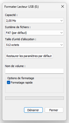

My problem: when I leave the USBD_STORAGE_Write and USBD_STORAGE_Read functions empty, Windows can see the size of my disk and offers to format it (without success):
And when I implement these two functions (based on the only example I found online using the Levelx functions lx_nor_flash_sector_write and lx_nor_flash_sector_read: LINK), Windows can no longer read my disk volume or offer to format it. I think my functions are not defined correctly :

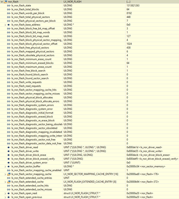

I still haven't managed to resolve this issue.
For your information, here is the information from my storage instance when I do:
lx_nor_flash_open(&nor_flash, "NOR_FLASH_DISK", lx_stm32_nor_custom_driver_initialize);

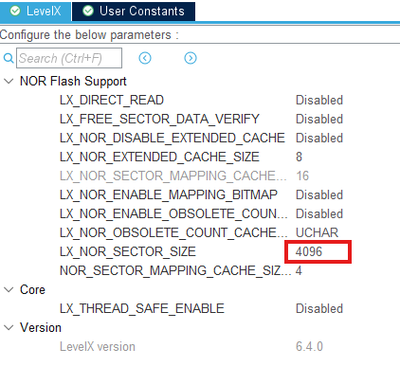

Does LX_NOR_SECTOR_SIZE correspond to the size of a physical sector?
Mine are 4096 bytes (or 1024 words). And will this value define the size of the logical sectors?
I have the impression that the logical sectors need to be 512 bytes.
Can you help me?
thanks
DmitryR
Senior
Hello RemiNao,
block size does not need to be 512 but you should return a corresponding number in USBD_STORAGE_GetMediaBlocklength(). But it makes just little sense to use large block size for NOR so I would consider setting it to 512. Also, consider returning UX_STATE_NEXT instead of UX_SUCCESS in these two functions. You may call lx_nor_flash_open() in USBD_STORAGE_Activate().
Regards,
Dmitry

Then, as I have already told your flash has physical sector size of 4K bytes so it is the absolute minimum that you should use for logical sector size. Otherwise LevelX will try to erase on 512 byte blocks which for your flash is simply impossible.
