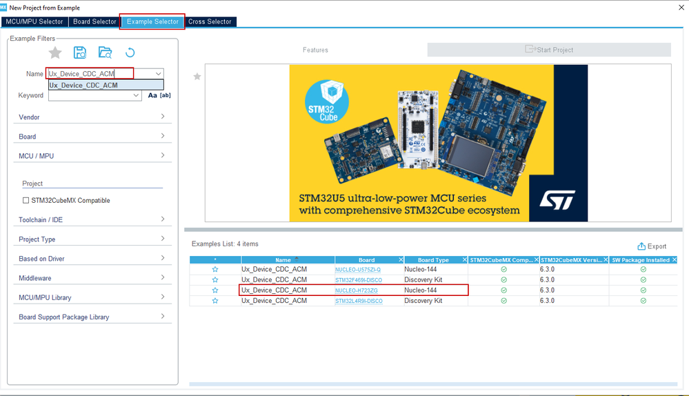

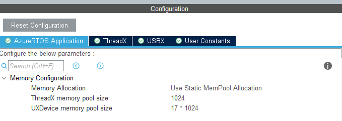

‎2021-11-12 7:29 AM
Hi @MDeva.1​
Normally you should use the the "static memory allocation" as suggested by STM32CubeMX Config UI.
if it is the case in your project then do not modify the flash.ld file.
you can use the "Example Selector" from STM32CubeMX to inherit the UX_CDC_ACM application for the STM32H723-Nucleo board, then you can use it as refererence to configure your own project for the STM32H745i.
