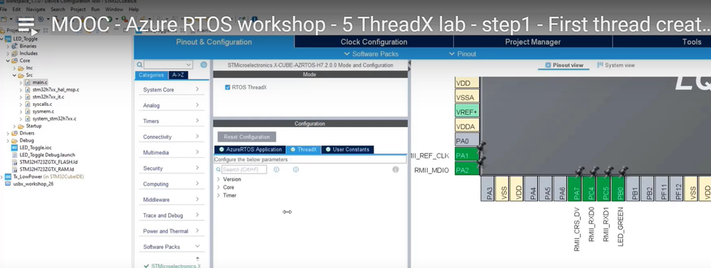

RomainR.
October 19, 2022
@XGao.2 (Community Member)
Check the Azure RTOS workshop MOOC on Youtube.
TOUT REGARDER
MOOC - Azure RTOS step by step workshop
I do not watch all part, maybe look in step 5 ThreadX Feature.

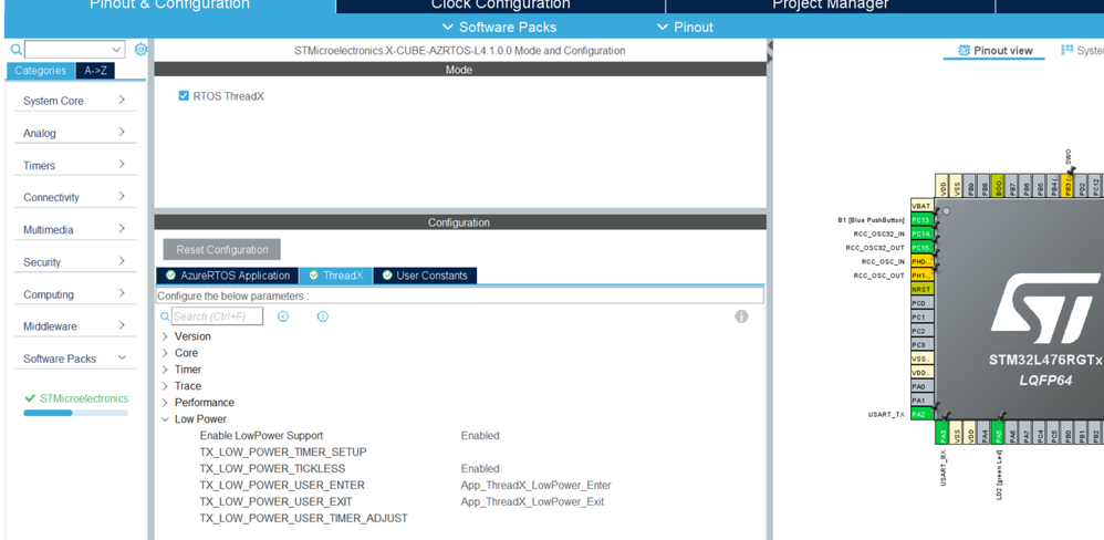

XGao.2
XGao.2Author
October 19, 2022
The low power functions is not included.0693W00000UoMMxQAN.pngSee my CubeIde:
0693W00000UoMNWQA3.pngAnyway, thanks again.
