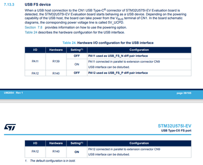

I have STM32u575I-EV evolution board and I want to use the board as USBFS Device and As Host.
Can some please let me know the jumper settings which needs to be done for configuring the board for device & Host?

Hello @RRajb.2 ,
You can review the settings in the STM32U575I-EV User manual and check Table 24. Hardware I/O configuration for the USB interface.

I have gone through the user manual you mentioned above for, configuring the STM32575i-EV evolution board in host mode.
But I don't see any specific jumper settings for usb host mode, only USB device settings are mentioned.
As per the below readme file.

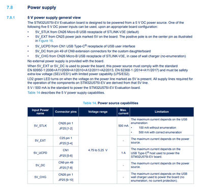

I have configured or connected below jumpers.
JP25 : UCPD_5V Jumper
JP6 (UCPD_SRC) : Please on this jumper UCPD_SNK02 is mentioned on board.
JP14 and JP15 : both are connected to 1-2.
I am trying to run the example code for Ux_Host_MSC, But Not able to see anything on console or not able to see any interrupts occurring.
Could you please let me know all relevant jumper settings for host mode?
I have attached the board image and have marked the jumpers, which I have connected.
