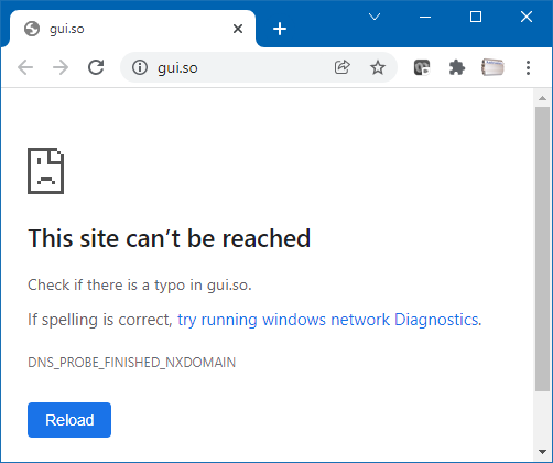

Your link doesn't work:
What does the "GUI.SO" documentation tell you?

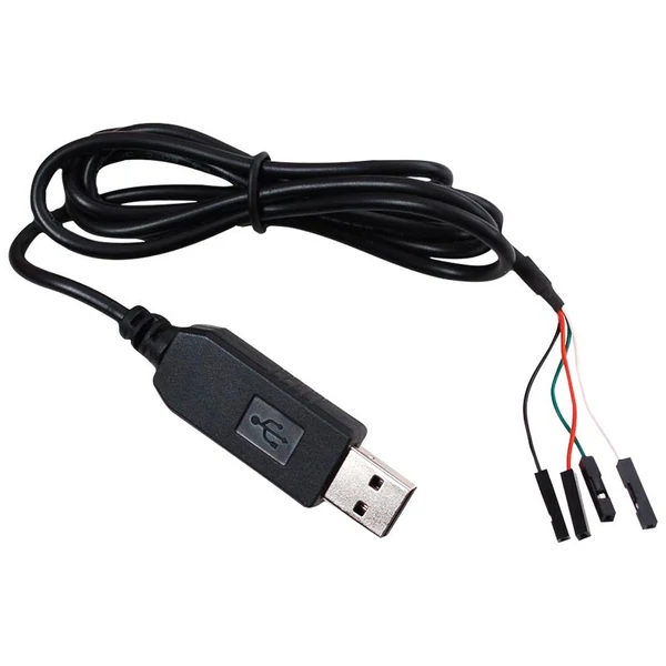

You can use whichever USB Class you like.
Common choices would be CDC - to give you a virtual COM port - or HID.
If you don't have (much) experience developing for microcontrollers and/or USB, it might be simpler to just use a UART on the microcontroller, and a USB-to-UART converter; eg,
