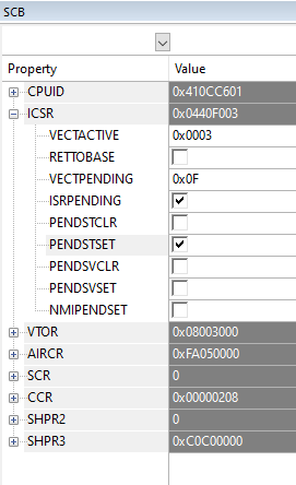

‎2022-01-07 3:52 AM
Thanks for the reply, I'm clearing the flags because on some forums, I saw those commands.
I have check the SCB and when my app crash I get this state and the only one who change is PENDSTSET
