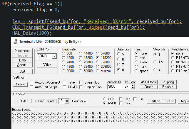

‎2021-11-16 4:05 AM
Hi, thanks for your answer! Whats sad about it, is that it doesn't work for me :\ Tried different delays (from 10, to 1000 ms). On terminal it looks like maybe its working, but i can't see received data.

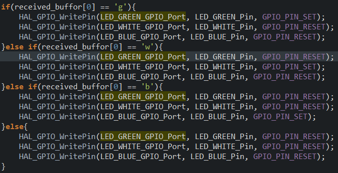

‎2021-11-16 4:07 AM
Also, received_buffor doesn't contain the data I've sent, because these conditions don't work (they worked before):

How do you know more than 1 byte at a time is being sent? CDC_Receive_FS will receive the entire packet, up to 64 bytes. It's up to the sending program to put more than one byte per packet.
Variables used in both ISRs and the main loop should be marked volatile.

‎2021-11-16 6:05 AM
Yep, it was terminals problem....
I used Terminal, Putty and Atollic's debugger terminal - all of them is sending 1 byte.
I have written terminal on pythons pyqt5 and it works!
