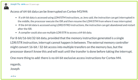

From my read of the linked thread, the STRD instruction can be interrupted mid-way through by an ISR, and then restarted in full again, leading to 3x 32-bit writes. Which would lead to a PGSERR error. Maybe that's why HAL treats it as 2x 32-bit writes. Or maybe they just got lucky.
https://community.arm.com/support-forums/f/architectures-and-processors-forum/4201/c-c-atomic-operation-on-arm9-and-arm-cortex-m4
Copying it here in case the page dies.
So yes, it exists. It's not atomic. And it will make 0 difference in flash endurance.
@TDK There is something wrong with the statement above. I did a quick research of ARM architecture documents and I couldn't find any trace of LDRD/STRD being interruptible. LDM/STM can surely be interrupted, then continued after interrupt return. Making the LDRD/STRD interruptible would only speed up the interrupt response by one cycle - not worth it, considering the added complexity.
This is not to say they cannot be aborted and restarted after ISR return, it's just I can't see any reliable trace of this possibility in ARM documents - v7-M RefMan and CM4 TechRefMan. I believe such feature would be described in the manuals if it existed; note that LDM & STM abort/restart behavior is fully documented.
