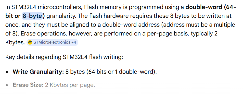

I recall reading in documentation, perhaps rm0432,  that the flash is 64 bits wide.  I would prefer to do a single write of a float value 32 bits.  The only reason I went to 64 bits at a crack was (possibly in error) because of endurance.
I shall work some more at this.  Thanks.
@TDK Actually you can write 64 bits with a single ARM instruction - STRD. And the compilers do that! ;)
