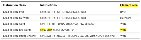

The STRD/LDRD instructions store and load a 64-bit value. Internally, they are broken up into 2x 32-bit accesses.
Since the element size is a word and not a double-word, they are not atomic in the same way that a uint32_t is atomic.

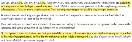

The ARM reference manual has this to say on the subject:
https://developer.arm.com/documentation/ddi0403/latest
To me, it seems they are restarted based on this text, but the two "might" words here leave ambiguity.

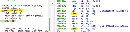

To test, let's make a program and see what happens. The test program uses TIM1 as the interrupt source and interrupts execution every 40ish cycles, which get varied a bit in the ISR. This is on an STM32F411RE.
In the main loop, we modify a uint64_t with LDRD/STRD commands so that each half increments by one. The disassembly shows the compiler uses LDRD/STRD instructions for this.
In the interrupt handler, we check to see if the two halves are ever out of sync. If they are, save save the value and then reset it to 0 to see if both halves will be re-written (instruction is restarted) or if only the second half is (instruction is resumed). This is then detected in the main loop and the programs stops.
So what happens?
The interrupt handler is called between the two 32-bit writes and detects an intermediate state on the uint64_t. When this happens, the first uint32_t is updated while the second still has the old value, so they differ by 1. This means STRD is interruptible mid-instruction.
After returning from this intermediate state, the main thread re-writes both halves of the uint64_t. This means STRD is restarted rather than resumed when it gets interrupted.
