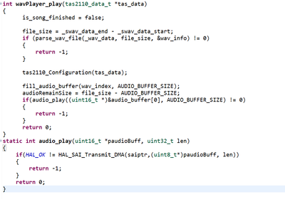

I’m working on playing audio on the TAS2110 codec using the STM32U5G9J-DK1 board via SAI.
  • I tested with generated sine and square waves, and I can hear output on the speaker.
  • However, when I try to play audio data stored in memory, I don’t get any sound.
To store the audio file, I created a .s file as shown below:
.section .wav_data, "a"
.global _wav_data
_wav_data:
.incbin "C:/Work/Project/Project/audio_codec/Core/Src/wav/audio.wav"
.global _wav_data_end
_wav_data_end:
I can parse the WAV data using my parser API. Parsing works fine, and I copy the samples into a buffer, then send it to SAI via DMA.
Could you please help me identify what I might be missing? Why do I not get audio output from the speaker when streaming from the WAV file?

Audio Play API
static int audio_play(uint16_t *paudioBuff, uint32_t len)
if(HAL_OK != HAL_SAI_Transmit_DMA(saiptr,(uint8_t*)paudioBuff, AUDIO_BUFFER_SIZE))
return -1;
return 0;
int wavPlayer_play(tas2110_data_t *tas_data)
uint32_t wav_size = _swav_data_end - _swav_data_start;
file_size = wav_size;
if (parse_wav_file(_wav_data, wav_size, &wav_info) != 0)
return -1;
tas2110_Configuration(tas_data);
fill_audio_buffer();
if(audio_play((uint16_t *)&audio_buffer[0], AUDIO_BUFFER_SIZE) != 0)
return -1;
return 0;

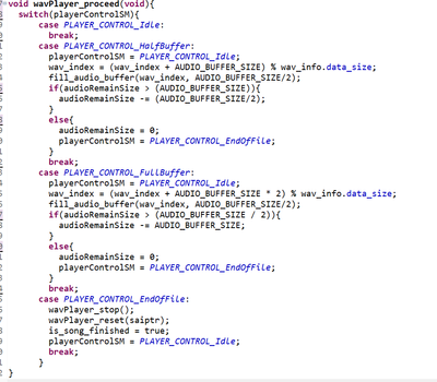

Callback APIs:
void HAL_SAI_TxHalfCpltCallback(SAI_HandleTypeDef *hsai)
HAL_SAI_Transmit_DMA(hsai, (uint8_t*)audio_buffer, AUDIO_BUFFER_SIZE);
void HAL_SAI_TxCpltCallback(SAI_HandleTypeDef *hsai)

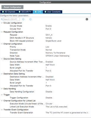

Hello @Jinal
Why did you set pNodeConfig.Init.DestInc to DMA_DINC_INCREMENTED ? In your case (DMA memory to peripheral), it should be set to DMA_DINC_FIXED.
Please review the example I provided earlier for reference.

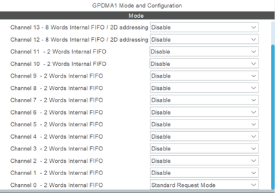

Hi @Saket_Om
Thanks for the response.
I’m using the same example, but the DMA callback is not triggered in Linked-List mode.
If I disable Linked-List and switch to List + Standard Request mode, I only get one buffer of output on the speaker (sounds like noise), and the callback is called only once.
Attached are the .c and .ioc files for reference.
Please advise if I’m missing something in the configuration.
Thank you

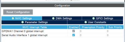

Hello @Jinal
You are not enabling the DMA interrupt in your code.
please add the instruction below in MX_GPDMA1_Init()
 HAL_NVIC_EnableIRQ(GPDMA1_Channel12_IRQn);
Saket_Om

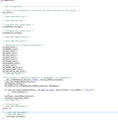

Hi @Saket_Om
Thanks for your response.
Now I’m able to get the DMA callback, but it only triggers once. My audio file size is about 680 KB, and I expect the half-transfer callback at every ~2048 bytes and the full-transfer callback at ~4096 bytes, repeating until the end of the file.
However, HAL_NVIC_EnableIRQ(GPDMA1_Channel12_IRQn); is still not firing when I enable circular transfer mode in DMA.
For your reference, I’ve attached the .ioc, main.c, and wav_player.c files. Could you please check if I’m missing something in the configuration?
Thanks,
Jinal

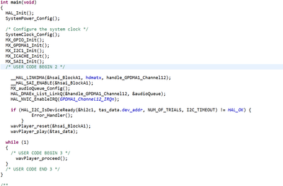

Hello @Jinal
According to your code attached in main.c you are not initializing the DMA;
In the MX_GPDMA1_Init() you are juste enabling the DMA clock and setting the interrupt priorities.
Please refer to the code below to initialise your DMA.
static void MX_GPDMA1_Init(void)
  /* USER CODE BEGIN GPDMA1_Init 0 */
  /* USER CODE END GPDMA1_Init 0 */
  /* Peripheral clock enable */
  __HAL_RCC_GPDMA1_CLK_ENABLE();
  /* GPDMA1 interrupt Init */
    HAL_NVIC_SetPriority(GPDMA1_Channel12_IRQn, 0, 0);
  /* USER CODE BEGIN GPDMA1_Init 1 */
  /* USER CODE END GPDMA1_Init 1 */
  handle_GPDMA1_Channel12.Instance = GPDMA1_Channel12;
  handle_GPDMA1_Channel12.InitLinkedList.Priority = DMA_HIGH_PRIORITY;
  handle_GPDMA1_Channel12.InitLinkedList.LinkStepMode = DMA_LSM_FULL_EXECUTION;
  handle_GPDMA1_Channel12.InitLinkedList.LinkAllocatedPort = DMA_LINK_ALLOCATED_PORT0;
  handle_GPDMA1_Channel12.InitLinkedList.TransferEventMode = DMA_TCEM_LAST_LL_ITEM_TRANSFER;
  handle_GPDMA1_Channel12.InitLinkedList.LinkedListMode = DMA_LINKEDLIST_CIRCULAR;
  if (HAL_DMAEx_List_Init(&handle_GPDMA1_Channel12) != HAL_OK)
    Error_Handler();
  if (HAL_DMA_ConfigChannelAttributes(&handle_GPDMA1_Channel12, DMA_CHANNEL_NPRIV) != HAL_OK)
    Error_Handler();
  /* USER CODE BEGIN GPDMA1_Init 2 */
  /* USER CODE END GPDMA1_Init 2 */
Saket_Om

Hi @Saket_Om
As mentioned earlier, when I configure the channel in Linked List mode instead of Standard Request mode, I do not receive any DMA callbacks.
I have tried the same GPDMA configuration as suggested previously. For now, I am focusing only on the Linked List mode, but I am not getting any interrupts. Could you please advise how to resolve this issue?
Below is my updated MX_GPDMA1_Init function:
Error_Handler();
Error_Handler();
Could you please guide me on why callbacks are not triggered in Linked List mode, and what additional configuration might be missing?
