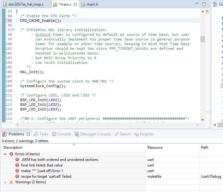

Hi everyone,
I want to start using the H743ZI serial communication with an hyperterminal software but i am not able to compile my project. I am using the STM32Cube_FW_H7_V1.3.0 UART POLLING example as a reference but everytime i try to compile my project i get those errors
.ARM has both ordered and unordered sections
final link failed: Bad value
make: *** [uart2.elf] Error 1
recipe for target 'uart2.elf' failed makefile /uart2/Debug
In my intent to solve this problem i delete this part of code:
 if(HAL_UART_Init(&UartHandle) != HAL_OK)
  Error_Handler();
and get no errors, but doing that i am not able to initialize the uart port.
Here is my main code, wish you can help me to face this problem.

The error suggests the linker doesn't like something, perhaps the linker script. Look to see if there is more output.
Sorry don't know enough about your build environment.
0690X000006DCaIQAW.jpgSorry if i didn't explain very well. I am using a nucleo H743ZI board , version of HAL is STM32Cube_FW_H7_V1.3.0 and i am building my code on System Workbench for STM32 Eclipse.
I attached an image to make it easier to understand
Imen.D
After check, the application is compiled successfully.
It seems that your problem is due to your linker options in the configuration of project and not the example code.

Hi Imen, thanks for your answer. Can you explain me how you configure your linker options in case of using a nucleo H743ZI boards, please. I want to see where my mistake is.
BRoss
Hi
I came across this same issue today, and got exactly the same error as described. I narrowed it down to an issue with one of the macros in stm32h7xx_hal_uart.h, UART_DIV_LPUART on line 1142, which is used in the UART_SetConfig method. After removing the (uint64_t) typecast from within the macro my code compiles without any issue. Putting the typecast back immediately brings the error back when trying to compile. I noted is that none of the other similar macros defined in that area of the header file use any typecasting in them.
Július Kovács
I also have this problem. I searched for the cause and found that the problem arises when the __aeabi_uldivmod internal function is called (in the UART_DIV_LPUART macro). This function is located in the libgcc.a library an is used by compiler to divide uint64_t numbers. The __aeabi_uldivmod function calls the __udivmoddi4 function (in the same library), which causes this error if is included in the project by compiler/linker.
I use the SW4STM32 IDE and toolchain (and library) has version 1.17.0.201812190825. Project is for Nucleo STM32H743ZI2 board.
You can also reproduce this problem by calling __udivmoddi4 from anywhere as follows:
main.c:
void __udivmoddi4();
void main()
   __udivmoddi4();
I don't know the exact reason, maybe the libgcc library is incorrectly builded, or my compiler or linker is incorrectly set, and unfortunately I don't have a good solution. But maybe this information will help someone.
Of course it is possible to download the source file of __udivmoddi4 from https://developer.arm.com/tools-and-software/open-source-software/developer-tools/gnu-toolchain/gnu-rm/downloads, unpack it, extract the definition of the __udivmoddi4 function (from the libgcc2.c file) and insert it to project in separate file. I tested it, it works, but it is not nice solution.
Július Kovács
check the linker script, and fix the ALIGN(32) values in .ARM block from value 32 to 4:
 .ARM : {
   . = ALIGN(4);
   __exidx_start = .;
   *(.ARM.exidx*)
   __exidx_end = .;
   . = ALIGN(4);
 } >ROM
It works for me.
