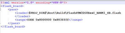

STM32G0B1KCT6 how to use dual bank as single bank to use full 256KB.
Sneha
I am using STM32G0B1KCT6 MCU, i would like to use the full flash of 256KB starting from 0x8000000 to 0x803FFFF. but am unable to flash in bank 2 (ranging from 0x8020000 to 0x803FFFF).
if i reduce the flash size to Bank1 only, then am able to flash and run the code.
I am aware its default dual bank MCU. PFA code snippet for changing it to single bank.
Also tried changing it single bank using the stcubeprogrammer but still fails to flash the MCU.

Also the flash region defined for dfu use is used as @Internal Flash /0x08000000/128*002Kg where it fails ...
but works when reduced to single bank with flash region defined as @Internal Flash /0x08000000/64*002Kg
Attached image error appears when tried flashing through the IAR IDE.
How do i resolve this to use full flash as single bank without bank separation.
Please guide through to work as per the requirement
Sneha

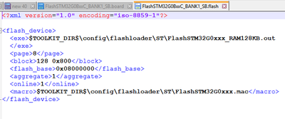

The IAR IDE flasher used by the for flashing the MCU via debugger used the below attached files and spec that defines the banks separately and does not allow write over bank2.
These files are now modified with full memory usage for the given MCU., which now allows writing into BANK2.
