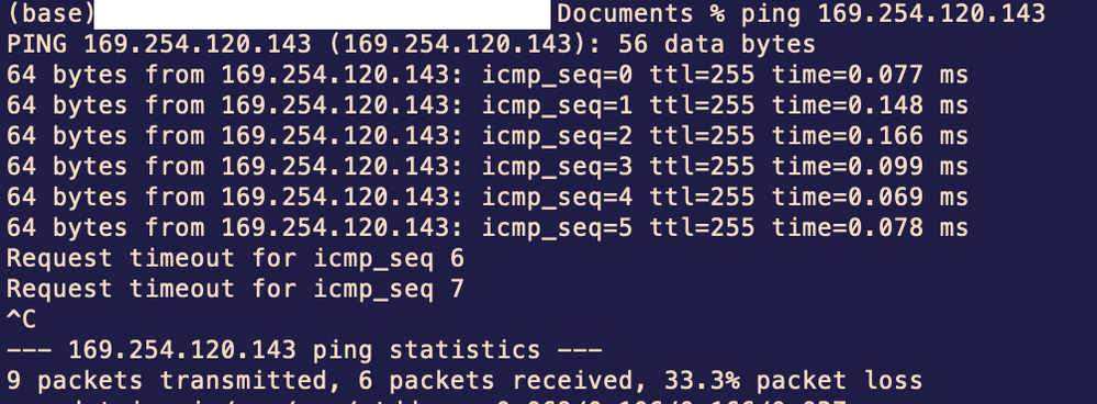

Hi, I am unable to get DHCP working. I am using the DP83848 board with an STM32F4 Discovery board. I am using the STM32CubeIDE and so had the code generated, the DP83848 is working on RMII mode.
When I enable or disable DHCP and connect it to my PC/laptop it would read an IP address of 169.254.***.*** of some sort with a MAC address of 00:e0:4c:68:01:a8 when it should be 00:80:E1:00:00:00 according to the configurations I can see in the IOC for the project. Anyone know why this is? Thanks in advance

I think it is the discovery board as when I ping it while connected, it is able to ping it correctly but as soon as I plug it off it is unable to ping it anymore like in the screenshot attached. But I will try to get my laptop working as a DHCP server first. Any other suggestions? Thanks0693W00000Lx81nQAB.png
Address like 169.254.x.y is APIPA address.
Check if your LwIP options file enables APIPA.
waclawek.jan
169.254.x.y is consequence of AUTOIP being enabled in lwipopts.h
http://www.nongnu.org/lwip/2_0_x/group__lwip__opts__autoip.html
Check if you have DHCP enabled, if dhcp_start() is called for the ETH netif, observe the netif's dhcp struct values, observe on bus if your device sends DHCP_REQUEST broadcasts... i.e. debug as usually.
