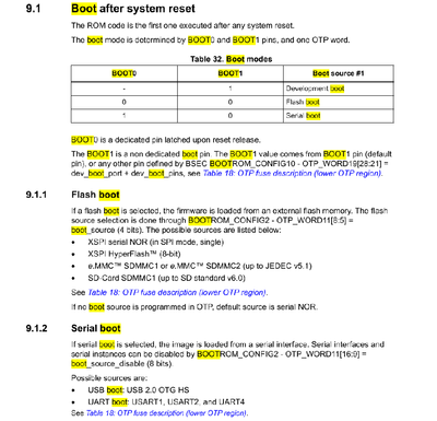

I configured the boot pins as mentioned in the datasheet:
  • BOOT0 = High
  • BOOT1 = Low

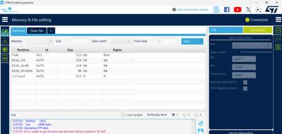

  • The device is detected in STM32CubeProgrammer when connected via USB.
  • USB connection is successful.
  • Partitions such as FSBL, RSSE_FW, RSSE_BLOB, RSSE_PLUGIN, etc., are visible.
  • However, the Download / Erasing & Programming option is disabled.

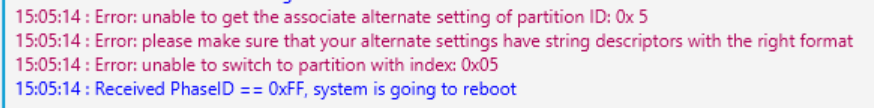

In this case, I am not able to flash, and STM32CubeProgrammer shows an error:
