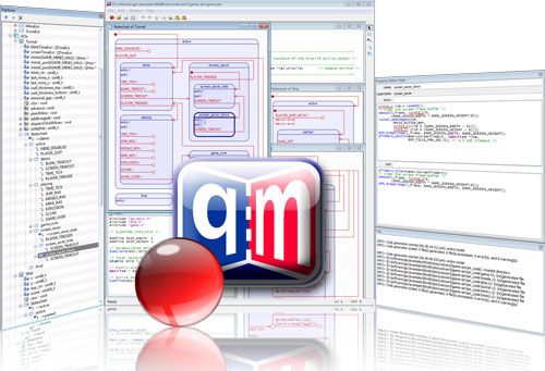

Update: Quantum Leaps offers now a
free, cross-platform, graphical UML modeling tool called QM? (www.state-machine.com/qm) for designing and implementing real-time embedded applications based on the QP state machine frameworks. QM? provides best-in-class, intuitive diagramming environment and generates very compact C or C++ code that is 100% traceable from your design. QM? is currently available for Windows and Linux (Mac OS X is planned in the future).
The code generated by QM works on the STM32 microcontrollers. For more information about STM32, visit www.state-machine.com/arm.
