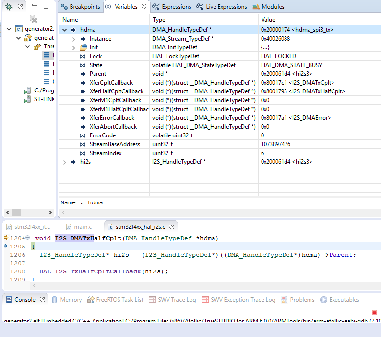

Posted on October 28, 2016 at 04:33
Yes, there are default callbacks, for example:
void I2S_DMATxCplt(DMA_HandleTypeDef *hdma);
According to UM1725, if you want to write your own callback you have to assign the function pointer to a variable member:
void HAL_UART_TxCpltCallback(UART_HandleTypeDef *phuart)
hppp->DMA_handle->XferCpltCallback = HAL_UART_TxCpltCallback;
Also, you can assign the callback using something like this:
HAL_DMA_RegisterCallback(&hppp, HAL_DMA_XFER_CPLT_CB_ID, HAL_UART_TxCpltCallback);
I tried both, but no luck.  My callback is never executed.  The ISR is working fine, but then it executes the default callback.  Any ideas?
