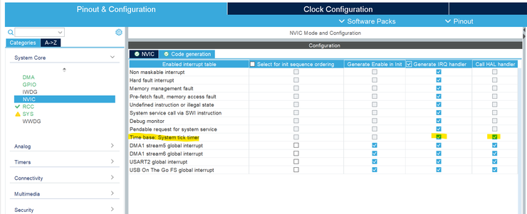

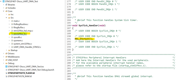

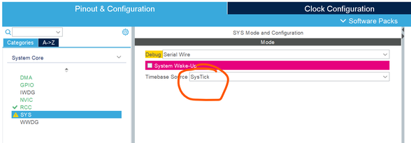

Ok, so now we know the problem. You should have said you're stuck in that function the first place, instead of only saying "i jump suddenly in here".
Sounds like the System Tick is not working.
Make sure you've have it selected
And that the NVIC is correct
If you do have it selected, then try debugging. In the stm32f4xx_it.c file, place a breakpoint on the HAL_IncTick and run in debug mode.
If it doesn't break on you breakpoint, then maybe it's a clock issue?

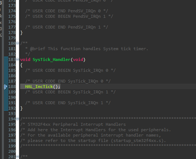

Thank you sir,
same  thing we have done as you told we have put up break point on it
while debugging mode after HAL_Delay(100);
we stuck on
void SysTick_Handler(void)
  /* USER CODE BEGIN SysTick_IRQn 0 */
  /* USER CODE END SysTick_IRQn 0 */
  HAL_IncTick();
  /* USER CODE BEGIN SysTick_IRQn 1 */
  /* USER CODE END SysTick_IRQn 1 */
here.
can you please guide me what's solution
