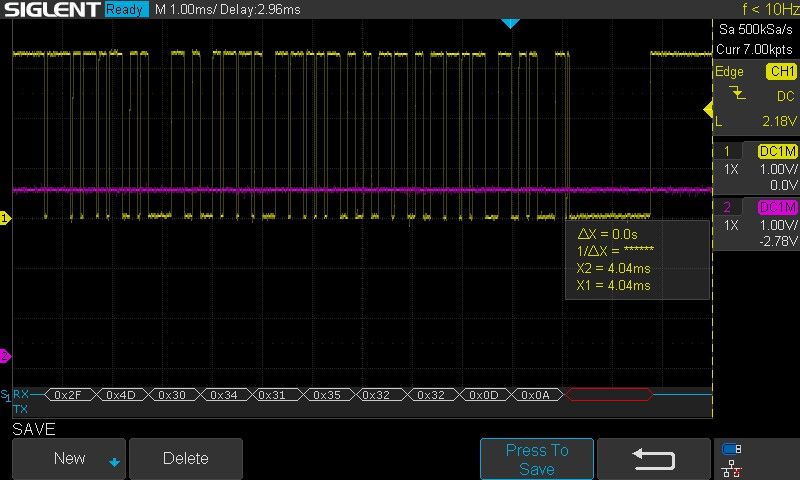

I am using stm32f411 MCU to receive data over UART.
The MCU acts as a bridge between two devices. PC & Meter device. both uses UART, but the physical connection is different.
the connection between the MCU & meter is current mode communication.
Speed is 9600 bps.
I tested it with 2400 & 4800 & both were fine.
When I tested it with 9600, the signal on the receive pin of the stm32 is ok. There are some garbage character in between two messages, but it works fine on 2400 & 4800 baud-rate.
The code is very simple, receive data from meter & forward it to pc & vice versa. It does that when a complete message is received.
I added a delay to start receiving only after the sending and there is a small character appears when the MCU & the meter switch the ownership of the current mode bus. The meter reply come after 5ms of switching occurs.
I attached snapshot of what is received on the RX pin
The debug data
& snippet from the code for the UART.

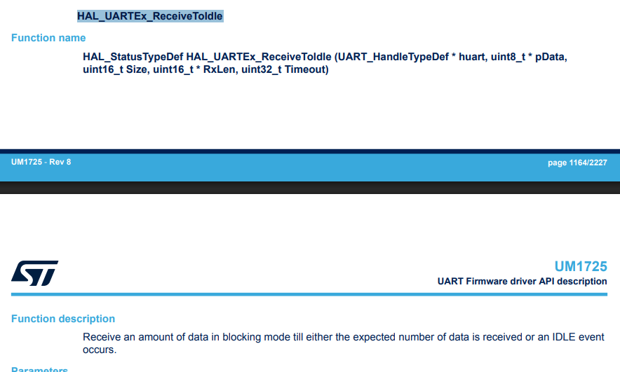

}HAL_UARTEx_ReceiveToIdle(&huart6, &received_from_pc, sizeof(received_from_pc), &received_from_pc_len, 10000);
if (received_from_pc_len > 0)
// HAL_Delay(500);
HAL_GPIO_WritePin(TX_ENABLE_GPIO_Port, TX_ENABLE_Pin, GPIO_PIN_RESET);
HAL_Delay(25);
HAL_UART_Transmit(&huart2, received_from_pc, received_from_pc_len, 3000); // for now.
HAL_Delay(10);
HAL_GPIO_WritePin(TX_ENABLE_GPIO_Port, TX_ENABLE_Pin, GPIO_PIN_SET);
// discard garbage invalid characters until we receive a valid start of frame character (0x15, 0x06 or 0x02) due to communication problems
uint16_t total_rec = 0;
do
HAL_UARTEx_ReceiveToIdle(&huart2, &received_from_meter, sizeof(received_from_meter), &received_from_meter_len, 20);
total_rec += received_from_meter_len;
} while (received_from_meter_len > 0 && (received_from_meter[0] != 0x15 && received_from_meter[0] != 0x06 && received_from_meter[0] != 0x02 && received_from_meter[0] != '/'));
if (total_rec > 0)
HAL_UART_Transmit(&huart6, &received_from_meter, total_rec - 1, 3000);

... and there is a small character appears when the MCU & the meter switch the ownership of the current mode bus.
I don't understand what you mean here.
There is no "bus ownership" for RS232, it only works as point-to-point connection between two nodes.
Or do you use RS422 / RS485 ?
And for RS232, you could only use hardware flow control to avoid collisions, or ensure within your software that both sides do not try to send simultaneously.

Since garbage characters appear between two messages, this issue is likely related to timing or, less likely synchronization issues. These are common causes of this symptom.
When reception starts after the bus switch, the line is not fully released, or the receiver is enabled before the bus is stable.
This issue is more visible at 9600 baud rates, because the UART has less tolerance to timing uncertainty than at lower baud rates, such as 2400 or 4800.
I recommend avoiding relying only on fixed delays. Use UART status flags and wait until the USART is in the correct state before switching the bus direction. This method is more robust than using arbitrary delays.
Also, can you Check whether any UART error flags are set during the switch. In particular, monitor the following:(Framing error, noise error, Overrun error, Parity error)
These flags help confirm whether garbage bytes are caused by a communication transition issue.

Also not sure what is going on in the posted code with you re-writing your own HAL_UARTEx_ReceiveToIdle() function?
That's a function which is (or should be) provided by the ST STM32CubeF4 Firmware Pack.:
And why are you calling it recursively?
