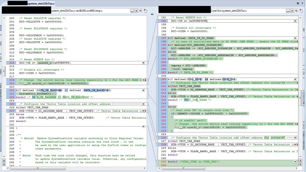

Ok this is how I fixed the issue (for anyone having the same problem).
Upgrading the SDK and generating code from CubeMX did NOT apparently change some critical new code in system_stm32h7xx.c that makes it all work.
So to fix, save your .ioc elsewhere, generate code and compare everything with your old code. There is just too much changes to the SDK to have this work magically.
Here's just a part of everything that changed which CubeMX didnt do on my older 1.3.2 rev:
