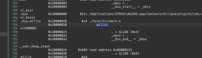

Seems like SysTick_Handler had a valid memory region:
Andrew Neil
Have you determined yet what is causing it to enter your default handler?
Is it a Hard Fault, or not?
Yup, hard fault, thanks for all your help. Seems like I had an issue with my clock setup - when I ran it at 75MHz, I think I was supposed to set the power control scaling for it to be able to go that high. The system defaults to scale 2, which supports only lower clock frequencies; anything greater would need this code to be put before the PLL setup.
