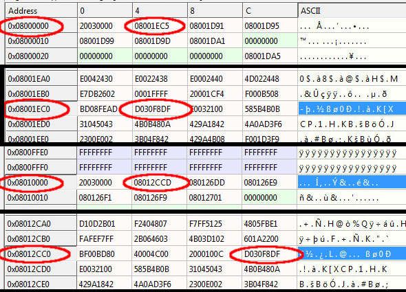

Hello, I'm trying to run this bootloader on a custom board with a 429IG on it. My target application runs fine, but I need to be able to update on site through usb.
So far, the bootloader writes the image on the chip, but it seems it doesn't jump to the application address. Here are my settings: Bootloader side:
#define APPLICATION_ADDRESS (uint32_t)0x08010000
#define VECT_TAB_OFFSET 0x00
Bootloader linker:
MEMORY
FLASH (rx) : ORIGIN = 0x08000000, LENGTH = 0x10000
RAM (xrw) : ORIGIN = 0x20000000, LENGTH = 192K
MEMORY_B1 (rx) : ORIGIN = 0x60000000, LENGTH = 0K
CCMRAM (rw) : ORIGIN = 0x10000000, LENGTH = 64K
Application side:
#define FLASH_BASE ((uint32_t)0x08000000)
#define VECT_TAB_OFFSET 0x00010000
SCB->VTOR = FLASH_BASE | VECT_TAB_OFFSET;
Application linker:
MEMORY
FLASH (rx) : ORIGIN = 0x08010000, LENGTH = 1024K - 0x10000
The bootloader is around 40k so it fits with the first 4 sectors. The jump code in the BL is the following:
if (((*(__IO uint32_t*)APPLICATION_ADDRESS) & 0x2FFE0000 ) == 0x20000000)
/* Jump to user application */
JumpAddress = (APPLICATION_ADDRESS + 4);
Jump_To_Application = (pFunction) JumpAddress;
/* Initialize user application's Stack Pointer */
__set_MSP(*(__IO uint32_t*) APPLICATION_ADDRESS);
Jump_To_Application();
I have tried to remove the condition and force the jump but nothing happens. I've read countless posts on the forum about that, (thanks Clive1 among others) but I still can't figure it out. Here's the interesting part of the memory view from the ST-LINK Utility after flashing the BL, and writing the target app from the usb key (the chip was fully erased prior to the procedure). 0690X000006033vQAA.jpg If anyone has an idea, I'm all ears :) Thanks, Dan. Edit1: picture didn't upload. Edit2: marked as solved #stm32f #rewrite #bootloader #iap #usb #flash

JumpAddress = *(__IO uint32_t*) (APPLICATION_ADDRESS + 4);
You want to jump to the address pointed too, not the BASE+4 address of the image itself, as a) it's EVEN and b) it's not code.

Thanks Clive, that did it!
