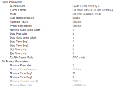

I am using a Riverdi STM32 Embedded Display RVT50HQSNWC00-B and having issues with the FDCAN bus. I am capable of writing to the TxFifo and can communicate with an external device in external loop back mode and normal mode. In external and Internal Loop Back Mode, nothing is written to the RxFifo. I am trying to use the board as a receiver not a transmitter. Are there any examples of FDCAN Rx communication with an external device using the STM32U5A9NJH6Q chip. When using CubeMX, there isn't any options for setting RxFifo elements in FDCAN configuration. Does this mean this board cannot be used a reciever, and only can transmit.

‎2024-06-14 9:51 AM - edited ‎2024-06-14 10:58 AM
Ill try to be more clear.
- I have successfully used Normal Mode to communicate with an External Device. As in, I am capable of sending a CAN message from the STM32 Embedded Display to my Raspberry Pi v4 with a 2 Channel-CANFD hat.
- I have not successfully used Restricted-Mode or Bus-Monitoring Mode to receive messages on the STM32 Embedded Display from my Raspberry Pi.
- In Internal Loopback mode, TxData is not mirrored in RxData.

‎2024-06-14 10:28 AM - edited ‎2024-06-14 10:30 AM
So if I understood well, even with Loopback mode you didn't succeed to receive messages? in that case drop Normal mode for the moment and let's focus on Loopback mode. Did you configure filters?
CubeMX doesn't allow me to edit any of Rx elements.
I need to check internally why there is no Rx FIFO elements setting in the CubeMx. It's true that U5 doesn't have the same FDCAN implementation as H7 for example but anyway I need to check.
‎2024-06-14 10:36 AM - edited ‎2024-06-14 10:58 AM
Yes you have understood correctly. I will focus on Loopback mode. Could this be a version issue with IDE/TouchGFX/CubeMX?
My configuration for filters is this.
sFilterConfig.IdType = FDCAN_STANDARD_ID;
sFilterConfig.FilterIndex = 0;
sFilterConfig.FilterType = FDCAN_FILTER_MASK;
sFilterConfig.FilterConfig = FDCAN_FILTER_TO_RXFIFO0;
sFilterConfig.FilterID1 = 0x123;
sFilterConfig.FilterID2 = 0x555;
if (HAL_FDCAN_ConfigFilter(&hfdcan1, &sFilterConfig) != HAL_OK)
/* Filter configuration Error */
Error_Handler();
