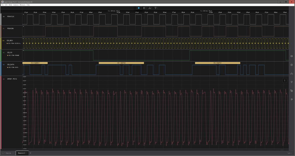

I get just 16bit per SAI_FS frame or 32bit per SAI_FS, but not 24bit! WHY?
Here the waveform with SAI_PROTOCOL_DATASIZE_24BIT used: see that 32bits are in a channel frame where I expect to see 24bits!

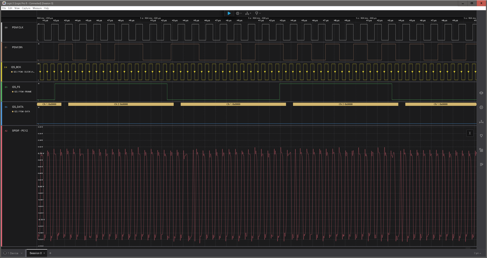

If I just change to:
if (HAL_SAI_InitProtocol(&hsai_BlockA1, SAI_I2S_STANDARD, SAI_PROTOCOL_DATASIZE_16BIT, 2) != HAL_OK)
I see 16bit per SAI FS frame - correct:

The HAL_SAI_InitProtocol function will program frame and slot configurations for the specified protocol according to data size and slot number.
In your case, you want to configure a frame with two slots, and a data size of 24 bits in I2S protocol.
I won’t detail all configurations but, if master clock divider is used (SAI_MASTERDIVIDER_ENABLE), the frame length must equal to a power of 2 to ensure that an audio frame contains an integer number of MCLK pulses per bit clock cycle.
On HAL_SAI_InitProtocol function, we have chosen to always respect it so if you want two slots with 24 bits data size, we configure a frame length of 64 bits (48 is not a power of 2).
You observe two slots of 32 bits (slot size) but each slot has a data size of 24 bits (data size).
It means that only 24bits are received on each slot (you can observe that the last 8 bits are null).
If you really want a frame length of 48bits, with two slots of 24bits, you can use HAL_SAI_Init function instead of HAL_SAI_InitProtocol.
But you will need before to configure FrameInit and SlotInit structure of SAI handle. Don’t forget also to disable master clock divider.
Hope it will be helpful for you.
